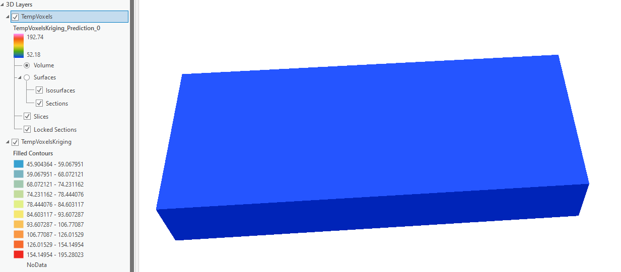

I am trying to make voxels from a geostatistical layer using GA Layer 3D to NetCDF. The tool runs successfully and the resulting voxel layer can be loaded. The default legend that pops up suggests that the values are in the expected range but in the local scene it shows up as only one color (suggesting that the value of every voxel is the minimum value or below the minimum value in the symbology). If I add a data filter in the symbology, filtering the data to only between the default minimum and maximum, then the blue box disappears. I can't change the minimum and maximum in the symbology to cover a wider range.

Well, I restarted my computer and it's fixed! I am truly mystified, as I also restarted my computer yesterday and that did not impact anything. My best advice to anyone who ends up with the same problem is to restart your computer multiple times!

Glad you were able to resolve the problem!  Voxel layers use GPU processing for rendering.  Restarting the computer and/or updating graphics drivers tends to resolve these kinds drawing issues.
