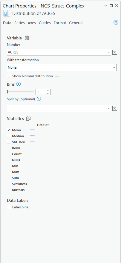

When I right click on a numeric field in an attribute table and select visual statistics it displays a pop up box with no data.  This happens across all projects and for all numeric fields in my projects.

  • Are you sure your field contains non-null values? If there are no non-null values, the chart will not draw and should display an error message. If a definition query or other filter is being applied and the result does not contain any non-null values, this would also result in a blank chart.
  • Thank you for the screenshot of the Chart Properties, but would it be possible to also post a screenshot of the chart view (where the chart should be drawn)?

I am also having this problem. The solution for me is to select Visualize Statistics a second time for the same field. Only then do the numbers populate.
ChristopherAllen
Hi @d484648 ,
Are you also on version 3.2.2? We were able to identify some scenarios where the histogram statistics were not populating initially, and this was recently fixed in Pro 3.4. If you are on 3.4 and still see this issue, please reach out.
