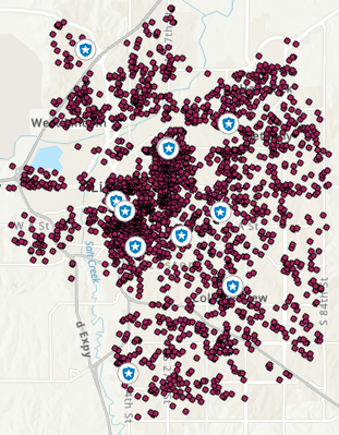

I am working with two layers, a point layer of crime locations and a point layer of police station locations:
For each police station, I would like to calculate the number of crime points that are closer to it than to any other station. For example, 30 crime locations occurred closest to police station X, while 50 occurred closest to station Y, etc. In ArcMap, there is an option within the spatial join dialogue box to give each target feature a summary of all points that are closest to it:
However, I don't see a similar option in ArcGIS Pro 2.4.1. I see an option to join the single closest feature to target features, but not all features that are closest to that station. Is there a way to do this in pro?
