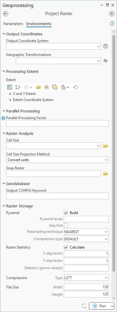

I "think" what may happening is your seeing the default environment settings of the Project Raster GP tool in play.  See image below.
Some items you could change are cell size, resampling method, and perhaps cell size projection method.  Tweak some of these settings and see what the result is.
