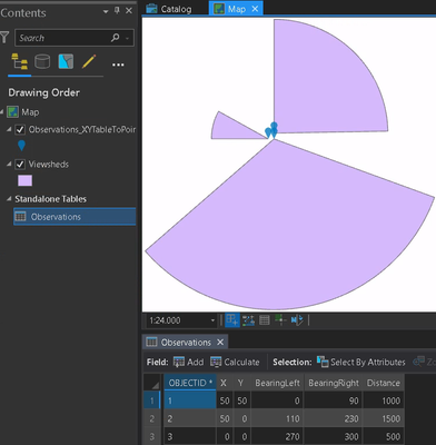

So, assuming you have a table like this:

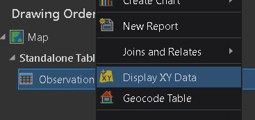

Display the locations
  • right-click the table in the table of contents, "Display XY Data"
  • Choose where you want to save the point feature class, choose the appropriate coordinate fields and your coordinate system, click OK.

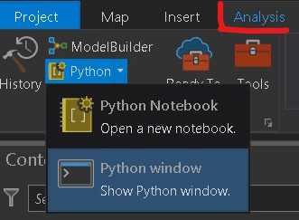

  • Open the Python window
  • Copy/Paste these functions and hit enter twice

  • Call the function
create_view_sheds("Observations", "memory/Viewsheds", "X", "Y", "BearingLeft", "BearingRight", "Distance", 25832)
