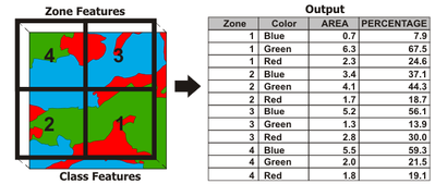

Tabulate Intersection will do the job efficiently, but according to the documentation, you'll need at least ArcGIS Pro 2.8
