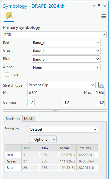

I can change the symbology: change red from Band_1 to Band_4. That can be done in the Contents pane or the Symbology pane.
ArcGIS Pro 3.4.3:
