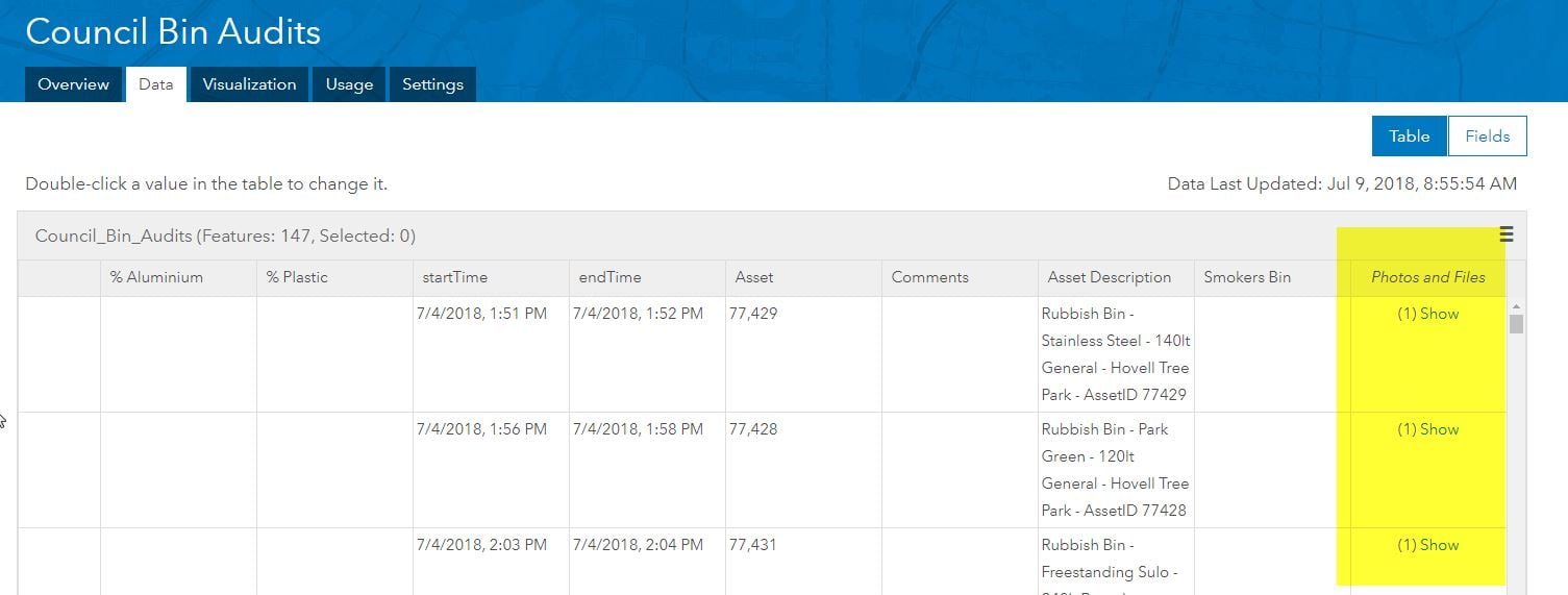

I can see all the data is being collected perfectly inside Arc , I can see attachments and attribute information.
Data being collected  perfectly

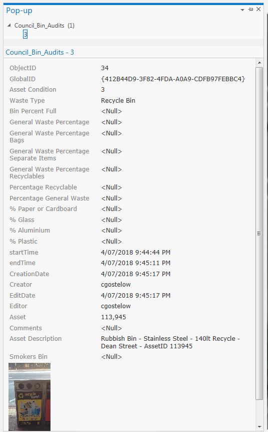

I then add this feature layer to ArcPro, I simply sign into my  account within Pro, and add the layer through catalog.
I then view the attribute table, there I can see each feature, but the Attachment column is omitted.
I don't want to symbolise or anything using this column, I simply want to click on the hyperlink to view the photos.
I have seen in the default pop-up that there is a thumbnail, but there is no way for me to click on it to view full size... any ideas?

In the pop-up configuration in ArcGIS Pro, switch on the option "Show list of Attachments":
This will display a list of hyperlinks in the pop-up window:
