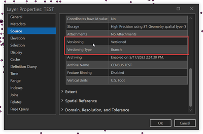

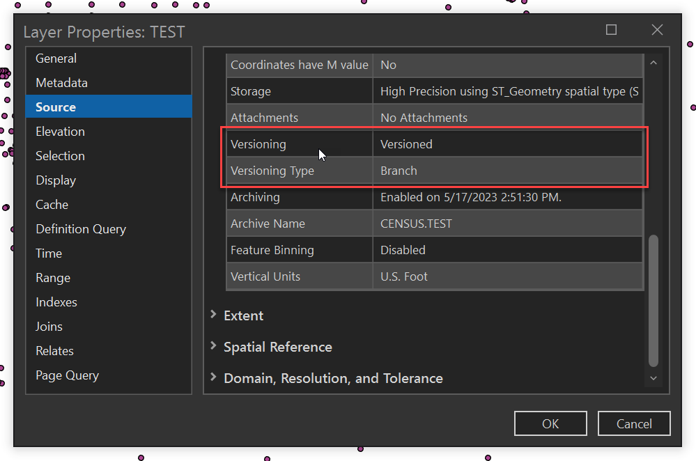

Hi all,
I have a feature class that is branch versioned and wish to publish to Enterprise Portal.  You can see below that the feature class is indeed versioned:

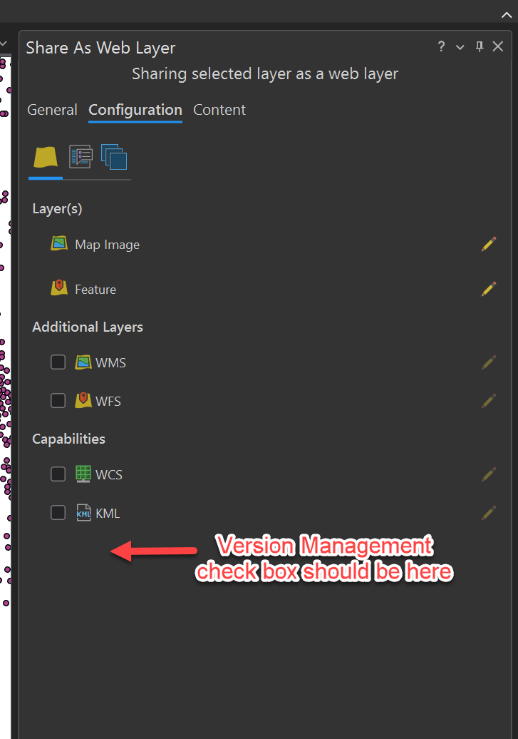

But when sharing map service with feature access (from a registered datastore), the option for version management is not available:
Any ideas why this is not available and how to fix it?

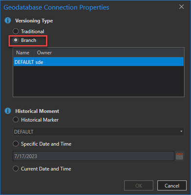

Hi @AngelaSchirck,
Make sure you're adding your feature class from a geodatabase connection that is connected to Branch versioning type in the Geodatabase Connection Properties:

Hi @AngelaSchirck,
AngelaSchirck
Thanks, that was the problem.
