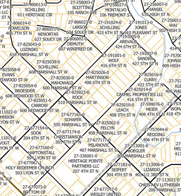

Is "Only place label inside polygon" honored in Vector Tiles?  I would like to make sure that labels do not cross parcel boundaries.
Note:  I tried using Standard and Maplex label engine.
Thanks!

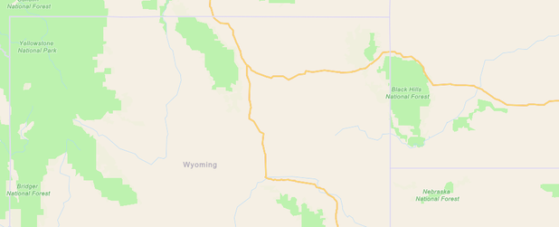

I did notice that Yellowstone National Park on the left side of the navigation map displays a label while the much smaller Badlands National Park on the right does not at this particular zoom level.  The label for the much smaller Wind Cave National Park does not appear until we zoom way into the map.  I wonder if the labels are drawn using "Area" or something else as a definition query.
Thanks!
  Perhaps this particular basemap
