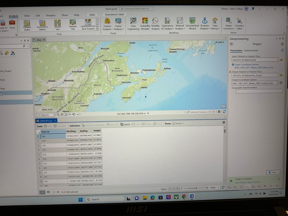

ShreyaArora
Here is a screenshot, of the data and where it is plotting now after the projection.
DavidPike
MVP Notable Contributor
I don't think there's any need for the Projection if you're certain the data is collected in the right coordinate system.  I think there's 3 likely possibilities in my mind:
1. The data isn't collected/recorded in the coordinate system you think.  Is there any metadata you can look into for the GPS to be sure?
2.  A data collection issue.
3. The correct coordinate system isn't selected at the initial Table To Point stage.  Looking at the Maine Coordinate Systems, there seems to be many, including meters/ft.
