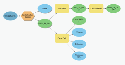

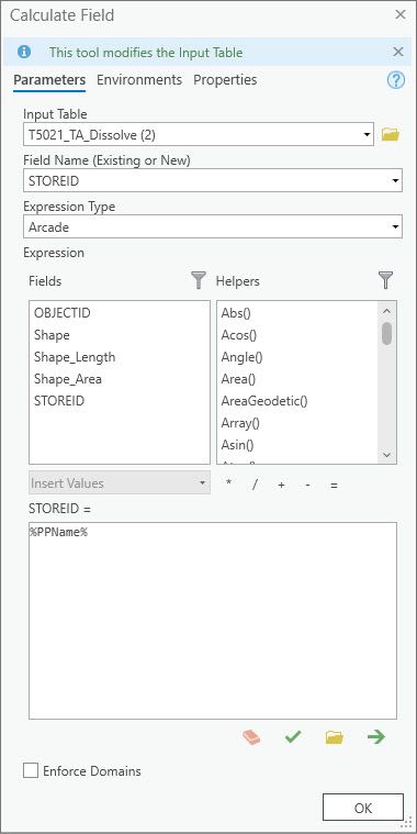

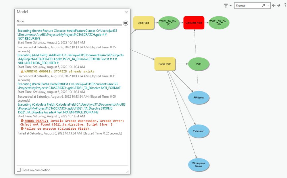

Trying to use the PPName field in calculate field, but it errors each time.
I had added %PPName% in the calculate field code box for Arcade. Is there something else I need to be able to do to be able to add this value to the fields when calculating.?

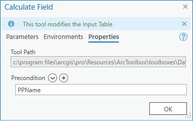

For some additional context someone had mentioned that I had not added the PPName variable as a precondition to the Calculate field. I did make that change
DuncanHornby
MVP Notable Contributor
This cross posting has been answered on GIS stack exchange here.
JohnDavidson
@DuncanHornby provided the solution on GIS Stack Exchange
1. Make PPName a precondition of of the Calculate Field
2. Update the calculate field expression to be "%PPName%"
Note: In this instance using the double quote will pass the variable and make it a text field which is passed through as a defined value. You must make sure that the double quotes are used when working with a text field
