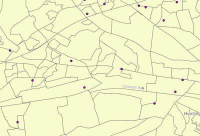

I have a table of bus stops with scores for each one and want to average the scores for the block group (polygon) that the stops are in. For example, if block group A has 3 bus stops with scores of 2, 3, and 4, I want the block group score to be 3.
I am unsure whether I need to do some kind of spatial join to connect the point(s) to the polygon. When I tried previously, the polygon layer attribute table would show that it had multiple joins, but it would only show one of the bus stop coordinates.
