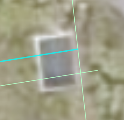

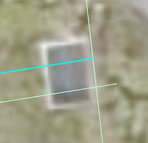

I am trying to edit a polyline in ArcGIS Pro but whenever I make an edit to the line, a duplicate of the line suddenly pops up in my map showing the edit I made in a different location and when I save my edits the line jumps to the wrong location. What is going on?

It's weird cause I don't remember this happening to me before and I've worked on this feature before.
When select the line and click Edit Verticies, the line becomes editable with the verticies on it and the duplicate line disappears. But once I make my edits and click the green checkmark to apply the edits, the duplicate line pops up.
