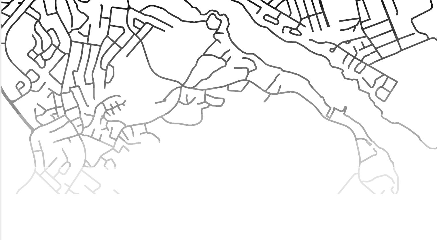

I am creating a map in layout and am using a rectangle to create a gradient but when I print to PDF there is lines where the gradient is shifting, the map is going to be printed so it will be noticeable, , wondering if anyone has found a way to make these lines go away?
I have outline width set to 0pt

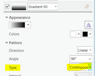

In the Gradient fill Pattern settings, change the Type from Discrete to Continuous.
