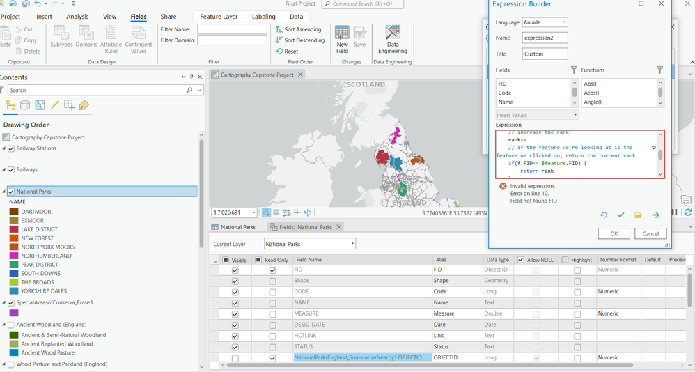

Thank you so much! This code has helped me a lot, but I've run into one problem while using it. I've tried OBJECTID and almost every field (alias and name) that my layer has that could match, but I keep getting the error message that the field is not found.
It's this line:
if(f.OBJECTID == $feature.OBJECTID)
I've found that I can double click the field for the $feature.OBJECTID part and the code fills in with my field, but the f. part just won't work. How do I fix this?
btw layer information is from here: https://naturalengland-defra.opendata.arcgis.com/datasets/national-parks-england/explore?location=52...
I've joined mine with another layer so it's not exactly the same
JohannesLindner
MVP Alum
Ah, joins.
When you add a join to a table, the full name of the field is used: Tablename.Fieldname (you can see that in your screenshot, too).
Clean solution: Instead of adding a join, use Join Field to permanently join the point count field to the polygons. This will change the polygon feature class, so it might not be possible for you.
Messy solution: use the full field names.
I downloaded the polygons and replicated your workflow: run the Summarize Nearby tool on the polygons and a point fc, join the output to the National Parks.
My feature class names are "National_Parks__England____Natural_England" for the original polygons and "parks_near" for the parks with summarized points.
This expression works for me:
// order the layer
var ordered = OrderBy($layer, "(parks_near.Point_Count / National_Parks__England____Natural_England.Shape_Area) DESC")
var rank = 0
// iterate over the ordered layer
for(var f in ordered) {
    // increase the rank
    rank++
    // if the feature we're looking at is the feature we clicked on, return the current rank
    if(f['National_Parks__England____Natural_England.OBJECTID'] == $feature['National_Parks__England____Natural_England.OBJECTID']) {
        return rank
Have a great day!
Johannes
junocs
Oh, I had no idea that join field was so different. I tried it the clean way and it worked! Thanks so much for your help
