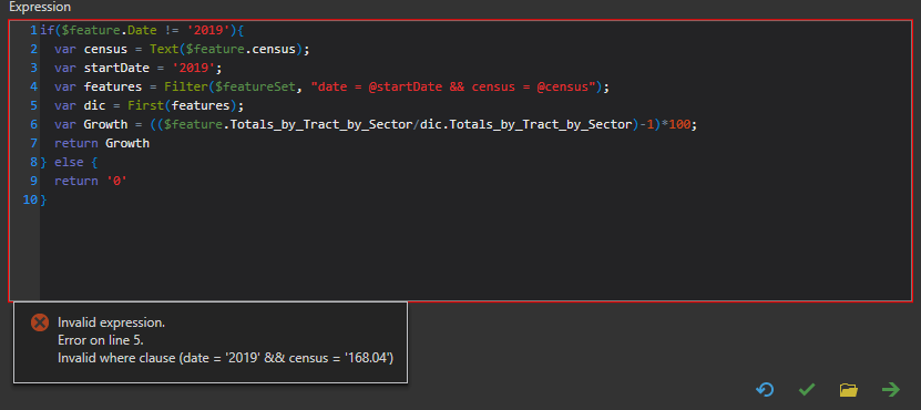

Hi,
In ArcGIS Pro, I am trying to implement a simple Attribute Rule calculation in Arcade and I am stuck with syntax! I am filtering the current features with an SQL type query and Arcade returns an invalid where clause...
In practice, this Filter function should return a unique feature with which I am performing a growth calculation on the current feature.
Any guess?

While many programming languages use the operator && as logical and, SQL uses "AND". So your query in line 4 should be
"date = @startDate AND census = @census"
Also, you're missing a null check after line 4. If the Filter function returns an empty featureset (nothing found with this query), First() will return null, and then you'll get an error in line 6, when you call null.SomeField
After line 5, insert something like this:
if(dic == null) { return '0' }  // I guess this is your default value, judging from line 9
Have a great day!

In your other answer, Arcade is complaining about census being empty. To solve that, replace line 4 in the script above:
if($feature.Date == 2019 || IsEmpty($feature.census)){
    return '0'
Have a great day!
Johannes

You said that $feature.Date is a double. You compare it to a string. Your condition will always be true, so the else block will never be entered.

You can't pass an Arcade operator, &&, in a SQL statement because whatever is processing the SQL has no clue how to handle &&.
