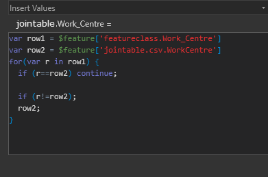

Hi @JoeBorgione I think this is what I'm looking for. Trying to implement now and see how it performs, but struggling with my newness to arcade and getting my head around the structure.
var row1 = $feature['featureclass.Work_Centre']
var row2 = $feature['jointable.csv.WorkCentre']
for(var r in row1) {
  if (r==row2) continue;
  if (r!=row2);
  row2;
Essentially in the code section of the Calculate Field tool I'm, trying to read 2 fields in a feature class joined to a table and compare the 2 fields. If values match, continue, if not, return value from the join table (row2). Any pointers on where I've gone wrong? It told me it was valid, but when I ran it, all values were calculated as Nulls instead of being left as they were or updated with new values.

I don’t see you returning a value to your expression. I’m responding from my phone so I don’t have anything I can grab for an example. I’ll try to remember you in the morning.
Another thing too, and just like in python, the continue/pass in this case may be syntactically correct but you need to return an actual value instead.

Thanks. I figure it's something simple but struggling to find an example that clearly breaks down the different components in a way I understand. Thought I was returning the value on the 2nd last line, but obviously not.
