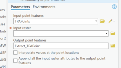

@Robert_LeClair I am having trouble finding that layer.  I have found https://www.arcgis.com/home/item.html?id=0383ba18906149e3bd2a0975a0afdb8e, which does not get added to the map when I try to, even though I'm logged into my AGOL account on Pro.  I have a dataset with about 38k points.  In fact, any elevation surface from Living Atlas I add to the Extract Values to Points GP tool Input Raster parameter in Pro just gets erased in 5 seconds and I'm unable to run the tool.
Do I need special permissions or am I doing something incorrectly?

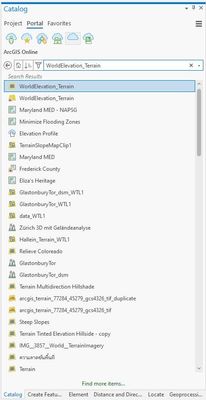

Jay - so I found the layer by going to the Catalog Pane in ArcGIS Pro, click Portal and All Portal.  From there I did a search on WorldElevation_Terrain and sorted by Relevance.  It's the first one in the search results.  Then I added it to my map view and that layer is then usable by the GP tool.

I am unable to add that layer to the contents of my map, either by REST url or by searching Living Atlas and adding the item.  The error is "Failed to add data: https://elevation.arcgis.com/arcgis/services/WoldElevation/Terrain/ImageServer".  Note even though there is a "REST" in the endpoint of the item, and that is what I try to add, the error in the url contains no REST.
If I try to add the item as the Input raster in Extract Values to Points, it thinks for a while then just erases the input.
If I try to add the item in the Input Image Service for Make Image Server Layer, I get the error "Failed to get raster. Please check if the input parameters is correct".
