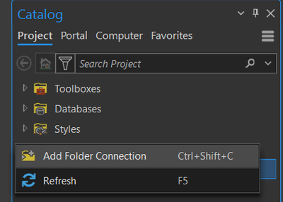

I am aware of the refresh directory trick (and the F5 shortcut).  This does not work.
Why is this one folder not visible (and unable to make a folder connection to) for only one individual.  My coworker has tried restarting their computer and then F5 refresh as well.

If not, I wonder whether right-clicking Folders > Add Folder Connection then pasting the full address of the desired folder (copied from Windows Explorer) into the Add Folder Connection window would work?
