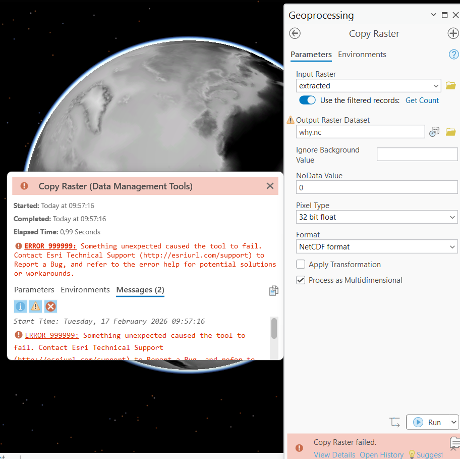

Have a .crf layer with "relative humidity" data with 12 StdTime sliced, 1 slice for every month.
Now I am trying to transfer this .crf to a NetCdf, however using the copy raster tool results in error 999999.
Anyone any idea how to fix this? Or an alternative way to go about this?

Copy raster does work perfectly for copying to.crf, but both options only export 1 slice of the raster when a .nc file is picked.

PimZaremba
same thing
