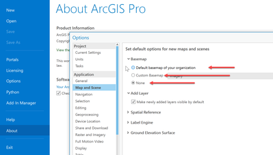

Did you try this????

The default setting is to take whatever the active Portal's default basemap is. Is it an option to just change to org default basemap?
