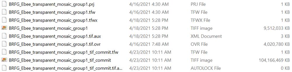

I'm trying to use the Pixel Editor to replace some areas from UAV imagery we flew. While it's working in Pro, when I try to save the changes it creates a 'commit' file that is far more massive than the original image.
A have a screenshot of the file sizes below. This is what was left after I left it on the 'saving' screen for about 4 hours and then cancelling it. I am trying again to today and it is still in the middle of saving after 5 hours. I am guessing it is writing it in a really high resolution, but the source image is in NAD83 US ft state plane, so is my map, and I haven't changed and cell size or spatial reference settings anywhere.

If you are using Save, it has to save the entire raster as if it is writing a new file.  It is possible that in this time there is inflated temp files. I do see that the file sizes are quite significantly different in size - is it possible that the source raster has been compressed?  That would also affect the source and temp file size difference.
As @DanPatterson mentioned, SaveAs will allow you to export the changes to a new raster dataset, which uses the Export Raster pane, you will have control over many aspects of saving out a new raster dataset - including compression.

The uncompressed size is 27gb, so still not sure where the +100gb is coming from. Could the tool just be straining with this large of a file?  I have hefty workstation with 32gb RAM, so it's not capping out there.

Jason, it might be struggling with a file that size, but it is just using the regular Export Raster (if you perform Save As). I am at a loss of what might be occurring.
