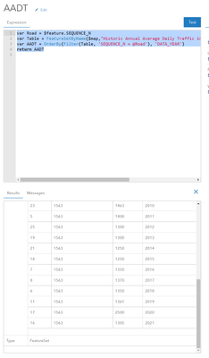

Teresa_Blader
Hi @XanderBakker ! I am also working through trying to do this similar work flow (layer and table). I can return the featureset, and I'm wondering if this is still a hault point or have there been advancements in the last couple years that lets me do this now? Trying to enable a way for a user to click on a road and see a line chart of the counts over the years from a table associated with the roads SEQUENCE_N.
var Road = $feature.SEQUENCE_N
var Table = FeatureSetByName($map,"Historic Annual Average Daily Traffic in Olmsted", ['SEQUENCE_N','DATA_YEAR','AADT'])
var AADT = OrderBy(Filter(Table, 'SEQUENCE_N = @Road'), 'DATA_YEAR')
return AADT (feature set)
Teresa Blader
Olmsted County GIS
GIS Analyst - GIS Solutions
Teresa_Blader

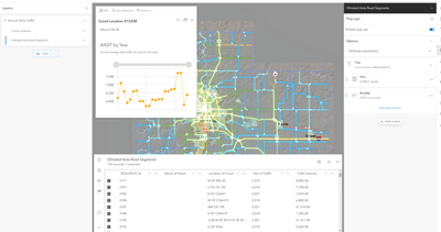

Teresa_Blader
I've sent you a direct message! This is how my map is set up:
Teresa Blader
Olmsted County GIS
by Anonymous User
Not applicable
With assistance from Teresa I was able to get my code up and running. Posting this comment/code with hopes of helping someone else. Background: I wanted to create a chart which shows ADT data by year to an associated road (MRNLINKID). I created a relationship class on Pro between the ADT Data Table (ADT_Data_Merge) and my Road layer, which was exported to AGO and inserted on new map viewer. Here is the code:
var Road = $feature.MRNLINKID
var Table = FeatureSetByRelationshipName($feature, "ADT_Data_Merge", ['Mean_ADT', 'Year'], false)
var AADT = OrderBy(Filter(Table, 'StationID = @Road'), 'Year')
var chartValues = {}
var chartNames = []
for (var f in AADT) {
        chartValues[Text(f.Year,'0000')] = Text(f.Mean_ADT,'###,###')
        Push(chartNames, f.Year)
return {
    type: 'media',
    title : 'AADT by Year',
    description : 'Annual average daily traffic by year for this road',
    attributes : chartValues,  // replace this dictionary with your own key-value pairs,
    mediaInfos: [{
        type : 'linechart', //linechart | barchart | piechart | columnchart
        //title : '',
        //caption : '',
        altText : 'line chart showing traffic counts by year', //altText will be read by screen readers
        value : {
          fields: chartNames,  // choose what attributes to use in the chart
          //normalizeField : '',  // the name of the attribute to normalize by or value
