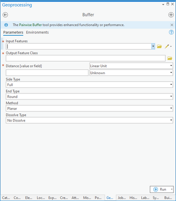

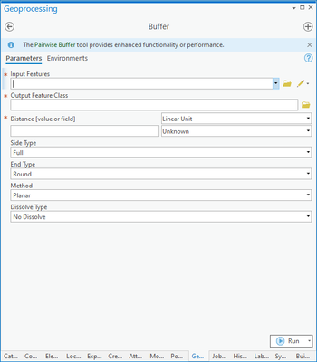

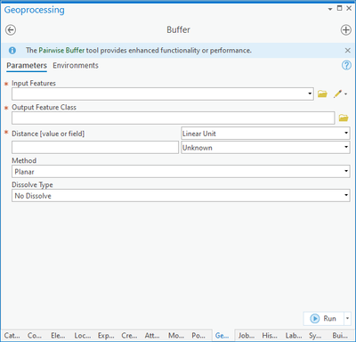

You are right. when basic license the tool looks like this
With advanced it is

Stefan_Thorn
With advanced it is

Stefan_Thorn
in the buffer tool in the screendump you have the side option.
