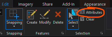

  • select an X feature (in the map or in the table)
  • open the Attributes pane (Map/Edit -> Selection -> Attributes)

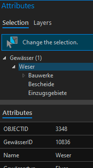

  • click on the triangle to the left of your selected feature, this shows a list of all exisiting relationships
  • navigate to your Y entry and edit it, apply (or auto apply)
