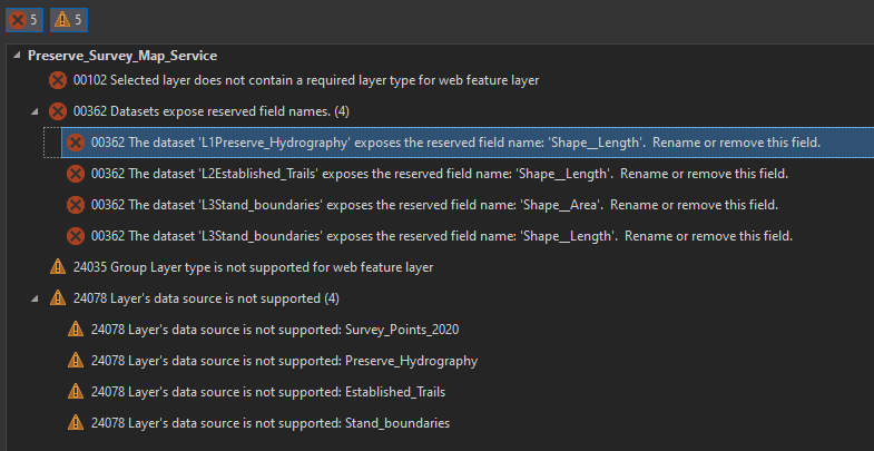

The problem is I'm not sure how to update the feature service without losing existing data in the tables. I have additional tables and relationships I would like to add to the feature service. I can bring the feature service from the portal into ArcPro and add new tables to the contents pane, but when I try to use Overwrite Web Layer I get several errors:
The 00362 errors only seem to happen when I try to publish/overwrite from items dragged from the portal - if I build the map directly from the geodatabase and publish the reserved field error doesn't occur.
I could do this each time (build a new map/service from the geodatabase) with the new tables and publish as a new web layer, but I lose the data we've already collected. I'm hoping someone can help me understand how to set this up so future updates can be published while keeping existing data intact.

Seems there is a disconnect between functions according to data source. You did not mention checking editing/publishing/overwriting (advanced type) settings/options in both sources.
You might also want to look into Append (Data Management).
