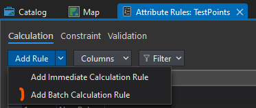

Well, you could implement your rules as Batch Calculation Rules and execute them with Evaluate Rules, which isn't quite one-click, but it doesn't take too long to start.

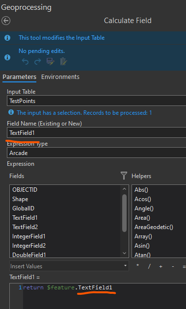

Take any editable field and do something like this:

You can do it manually, or you can do it with Calculate Field. Doing it with the tool has benefits:
  • faster
  • possible automation (write a little Python script or ModelBuilder model)
  • you don't actually have to change values. Just returning the value that is in the field will trigger update rules.
  • honors the selection in the layer, only those features will be updated
