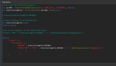

BrianBulla
Honored Contributor
Hi, yes, I have been building this step by step, so the names are correct.
I just did a re-type of the code and now it seems to be working.  Maybe the order in which the fields are updated makes a difference??  Or the formatting of how I have things typed in??  Now it looks like this and seems to be working.
This is my first time working in Arcade.  It seems very finicky.
