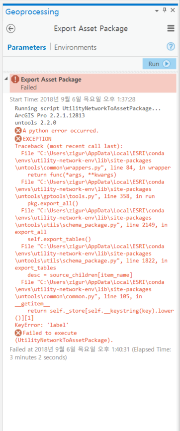

Hi,
I am experiencing this error when I run Export Asset Package tool. I am wondering if this is just me.
As far as I remember, I was able to export when I was following UNME configurations for the first time.
This time I am trying to export an Utility Network with some customer data.
How can I work around this?
Thanks.
Regards,
Min

MinShin
Hi,
This issue went away when I updated untools to 2.2.2.
Regards,
