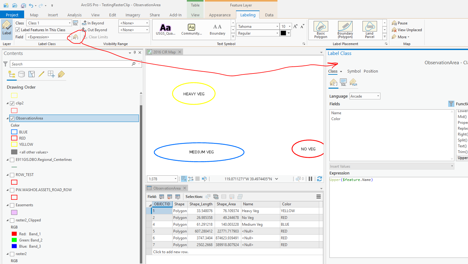

In #arcgis pro 2.3 patch 1, you can use Arcade expressions, via the Feature Layer, Labeling, Label Class pane.Pro Arcade Lableing
Not sure what "Disable and reset buttons" you are referring to.

Sorry Jay I had an older version of Pro, that's why I had no arcade functionality.  The updated version had a button for using arcade in the popup by creating custom field expressions, which allows for formatting. Looks great in Pro. Unfortunately, it doesn't look like explorer for IOS, latest version, supports the custom expressions, at least not yet, they display as blanks.
