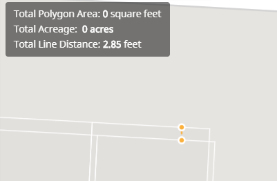

Did the update in ArcGIS Pro 2.2.2 change the internal workings of the Features to JSON function? There is now a 'Project to WGS84', which incidently does not work - does not change coords to decimal degrees - but also I am getting projection artifacts/errors. See the image below - one geojson exported with ArcGIS Pro Features to JSON, the other exported with esri2open. Approx 3' difference between the two. Looks like I have to go back and change all my models to use this old script unless Esri pushes an update to fix this. The original feature is in WGS84.

A couple things - first the whole projection issue mentioned above is the result of ArcGIS Pro having by default a transformation enabled for NAD 83 <> WGS84, while ArcGIS Desktop and earlier versions of Pro do not. See this thread - Converting NAD83 to WGS84 ArcMap vs ArcPro. I have not found a way to override this transformation in Model Builder in Pro, so until I can convert all my data to WGS84 with the proper transformation, I will likely be sticking with ArcGIS Desktop or QGIS to handle creation of GeoJSON.
The second issue is that even if you select "Project to WGS 84" when using Features to JSON tool, the coordinates stay in the native projection, meaning they do not get switched to decimal degrees per the GeoJSON spec (RFC 7946 - The GeoJSON Format). I have not tried this in a few months so I do not know if this has been fixed in any new versions. The workaround is to export a projected WGS84 layer, then run the Features to JSON tool on the newly projected layer.
