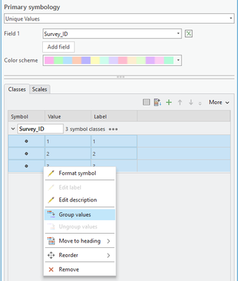

When an item in the Legend has unique values, but each value has the same symbology, is there a way to summarize the symbology for that item by the Layer Heading?  The only way I can fix this is converting the Legend to Graphics and going from there which I hate to do.  I was hoping ArcPro had fixed this problem by now...

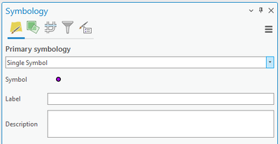

1. Change the Primary Symbology from Unique Values to "Single Symbol" in the symbology pane of your map.
2. If they have to be unique values (for some unspecified reason) then you can highlight each of the values in the symbology pane, right click and select "Group values".
GypsyHanks
 Thank you! Your #2 suggestion was just what I needed
