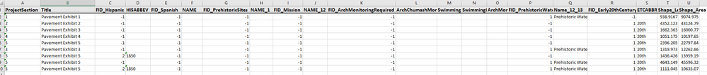

I ran a Union between project locations and sensitive environmental areas. I then filtered out only the project sections from the Union output. The table looks like this:
My goal is to automate this portion of cleaning up the data with either python or model builder within Pro.
