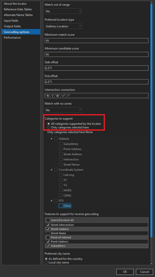

@RogerDiercks1 I was able to reproduce your results with a multirole locator; however, I did not need to set Match with no zones to YES. I was able to get results regardless of how that boolean property was set.
It appears the governing property is to have Categories To Support set to All categories supported by the locator. Screenshot of a configuration that worked for me is at the bottom of this post.
This is unfortunate because I really don't like to support the Street Name category as it is too broad and has limited or no use case for me. In fact, it actually invites more confusion for the fast-paced public safety environment I'm trying to fine-tune some locators for at the moment. It would be nice if Street Blocks was added as it's own category to support. I added this as an idea
