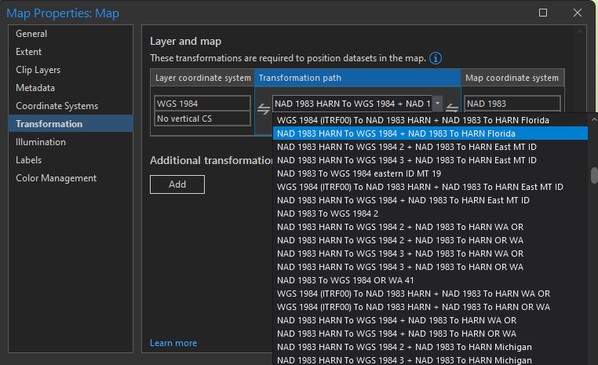

If you are generating your tile cache in Pro and exporting. It does not appear you can apply transformations as part of these geoprocessing tools.  However:
1) You can try modifying the transformation applied to the map you are generating the tiles from including a few combination transformations.  The default for WGS84 to NAD 83 is (WGS_1984_(ITRF00)_To_NAD_1983).  Try a few others such as:
  • (WGS_1984_(ITRF00)_To_NAD_1983_HARN + NAD_1983_HARN_To_HARN Florida)
  • (NAD_1983_HARN_To_ WGS_1984 + NAD_1983_To_HARN Florida)
2) Use the Project (Data Management) tool,  which allows the application of multiple/combination transformations to be applied, and create a temporary feature in WGS84 to generate your tiles from.  This may be the best option for you since you are generating and exporting your tile sets in Pro.
The selection of the applicable transformations really depends on the coordinate system of your original data and how to get it to WGS84.  AGOL automatically applies a single transformation to the source data and it does its best to select the correct transformation.  Currently, AGOL cannot apply multiple transformations, combination transformations (noted above) and will not apply any transformation if it cannot determine the correct one to apply.

We were able to finally create a tile cache that was correctly located by first reprojecting the mosiac to WGS84, then creating the tile cache. I did tweak the transformation from the default here as you suggested- after trying all possible options to the map before creating the tile cache unsuccessfully.
