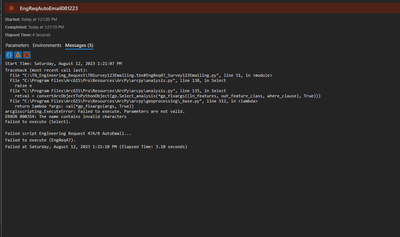

Hello,
I'm getting the following error when trying to schedule a Python script tool
It runs when I do it manually clicking the "run" button. It was also working before when I scheduled it

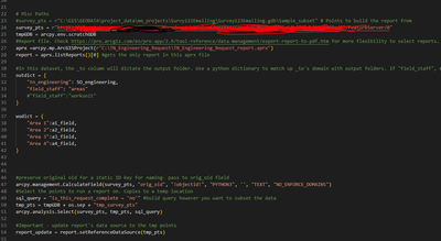

but now it doesn't. I tried changing the name of the scheduled task many different ways (no underscores, etc). it appears to be something with the output name of the arcpy select tool or the scratchGDB env. I attached a screenshot of the code for review.
Any help greatly appreciated.

on line 50, have you tried to raw-encode the tmp_survey_pnts? ( r" tmp_survey_pnts")
you do it everywhere else, except there

Adjusted it to r"tmp_survey_pnts". Still runs manually but not when I schedule it to run.
