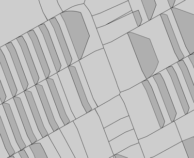

I should also mention that I'm still getting overlaps
