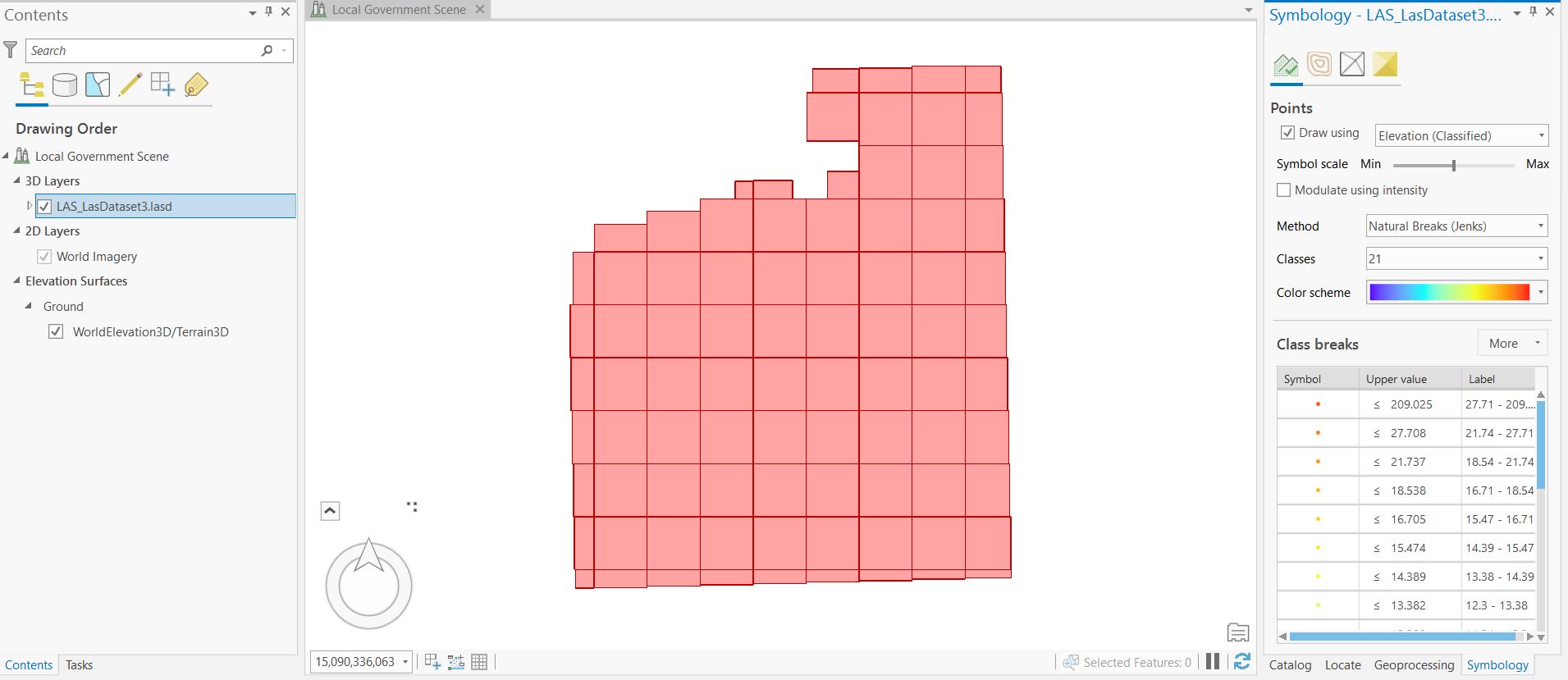

Hi, i am following the Create elevation layers—Extract Roof Forms for Municipal Development | ArcGIS tutorial to extract roof forms of my own lidar data.
when i create a LAS point cloud datasheet, i get a red bounded outline. i have tried zooming in to see the points and that also did not work.I have run my LAS files in Online LIDAR point cloud viewer and the points show up there.
I have also tried using the local government scene template.
it would be great if someone could help me as i need to get this running as part of my final year engineering project.

What are your appearance settings? Have you zoomed ALL the way in?
