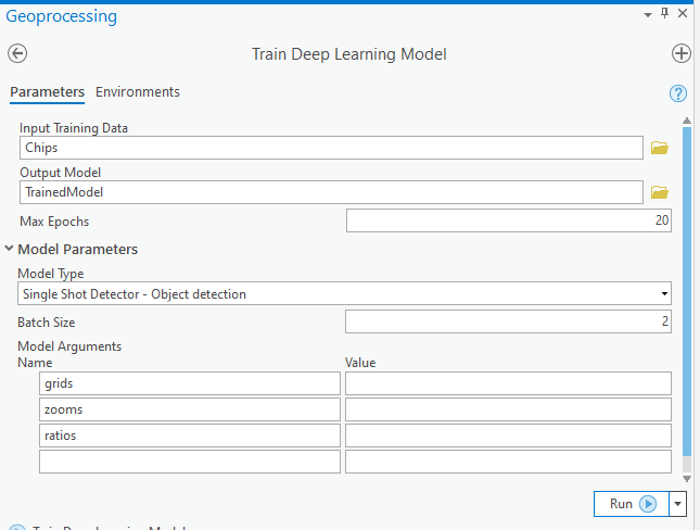

Hello, I am trying to use ArcPros 2.5 "Training Deep Learning Model" tool but I am running into some errors I am not sure how to handle.
I got my training data from the "Lable Objects For Deep Learning" Imagery Tool. These are my export options.

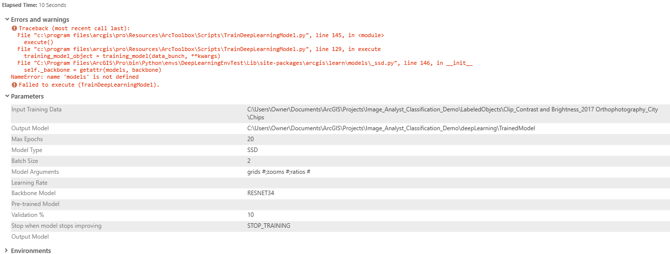

And that runs fine. When I try putting this training data into the "Training Deep Learning Model " I am getting this error.
I have done some google but can't find too much out there to help me. These are the other input options I am putting into the tool
if you need me to explain more of what I am doing or what versions of stuff I am using let me know and I will get back to you asap. I have been stuck here for a bit. Thanks.

Hi, did you get an answer in the meantime to your question?
I would check if you installed the required python packages for deep learning right:
Install deep learning frameworks for ArcGIS—Help | Documentation
Beside that I would check if your folder with image chips, labels etc. contains the right content.
DanPatterson
MVP Esteemed Contributor
BUG-000129130: The Train Deep Learning Model tool does not recogniz..
there are lots of issues with deep learning, most come down to the package versions being installed
