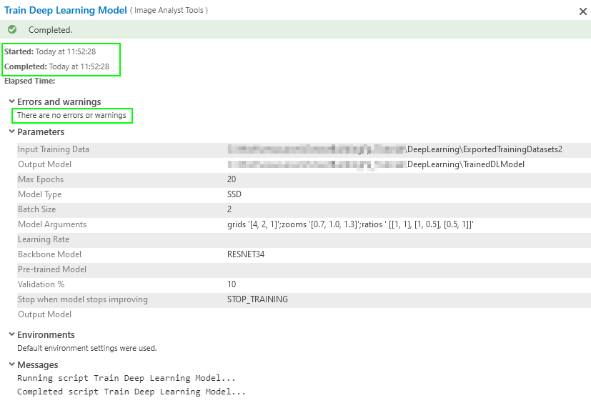

Hi,
The "Train Deep Learning Model" GP tool runs without error in less than a second and does not create any output, no even the destination folder.
All the dependencies are installed (Install deep learning frameworks for ArcGIS—ArcGIS Pro | Documentation ), the folder containing the image chips, labels, and statistics exists.
Have you ever experienced the same problem ?
Thank you
Theo

TheodoreDean
There was something wrong with my Python environment. I re-cloned it and reinstalled all the necessary packages and it's now working as expected.
