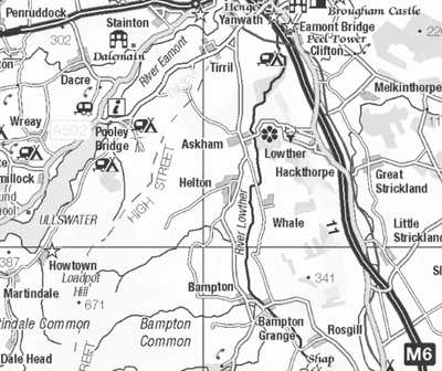

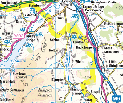

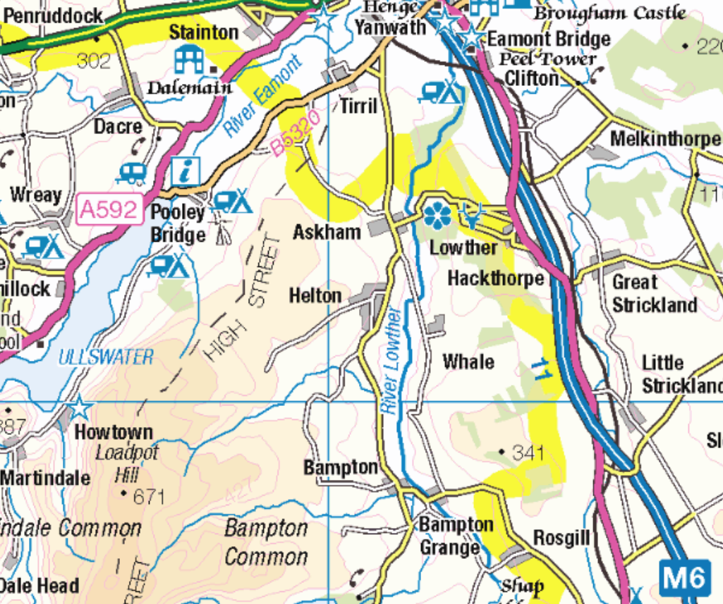

I am using some OS raster imagery stored in a Mosaic Dataset, and looking to use the Symbology Stretch functions to display it in greyscale / grayscale.
Here is the original colour version of the raster:

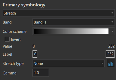

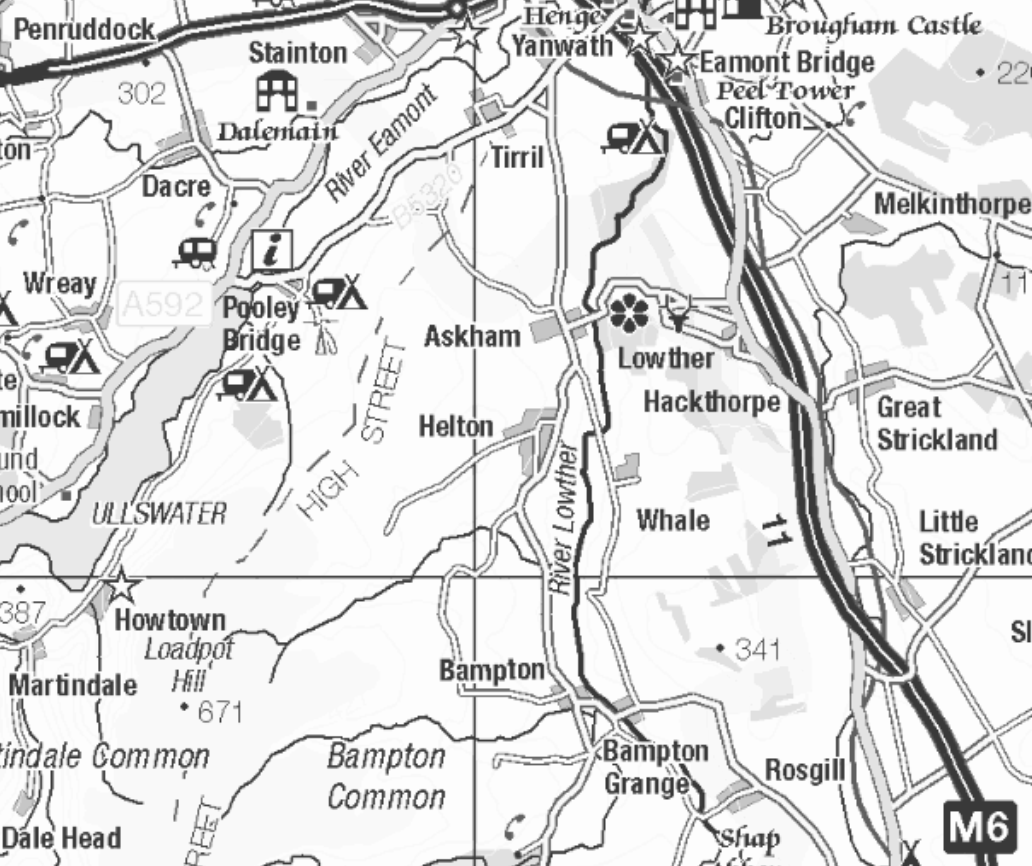

I applied these settings using the Black to White colour scheme and it now displays like below.
The terrain level shading in the mountains is now not visible and the large yellow banding has disappeared also. I've changed the Band settings and the Stretch types, some of them improves things slightly but none of them retain the detail of the original colour raster. Can anyone advise how I can produce an accurate greyscale raster?
Can I apply a stretch function on all 3 bands?
