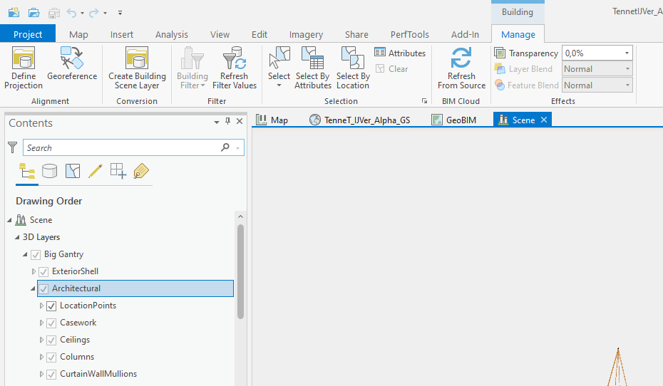

Default it is not possible to apply transparency on the level of a Discipline or when selecting the added Revit file in the TOC.

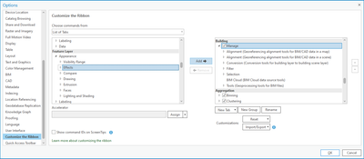

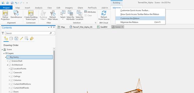

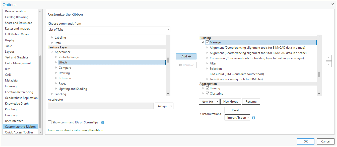

1. Select the Revit file in the TOC and right click on the tab ‘Manage’ > ‘Customize the Ribbon’
  • Or without opening a project > Tab Project > Options > ‘Customize the Ribbon’Stefan_Thorn_1-1654857733953.jpegStefan_Thorn_1-1654857733953.jpeg

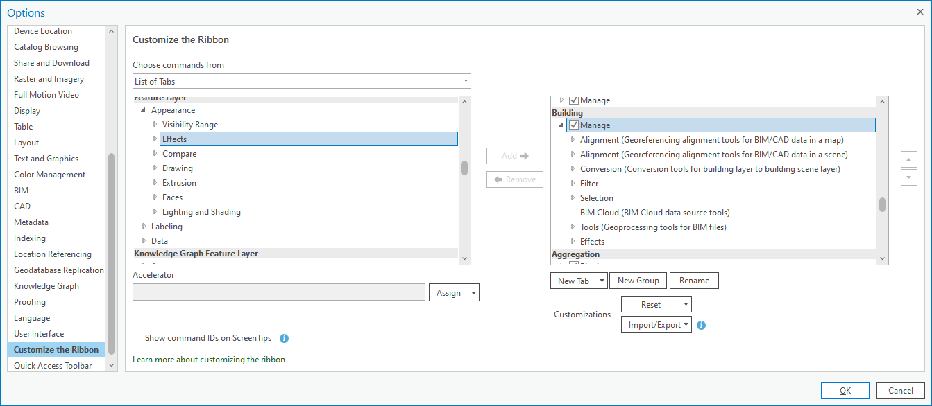

2. Choose commands from: ‘List of Tabs’:
  • Go to Feature Layer > Appearance > Effects (or any tab group that has ‘Appearance’ in it)
  • In the right go to Building and select Manage
  • Now add Effects to Manage and click OK
Stefan_Thorn_2-1654857831098.pngStefan_Thorn_2-1654857831098.pngStefan_Thorn_3-1654857840903.pngStefan_Thorn_3-1654857840903.png

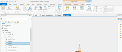

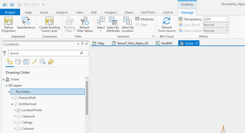

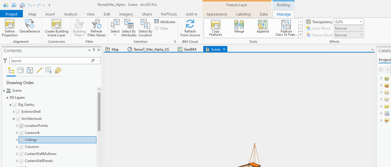

3. After customizing the Tab Building, when selecting each level of the added Revit file you can apply a transparency to that level. When you select a category also the ribbon Feature Layer will appear but that is default behavior.

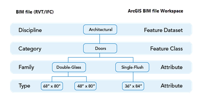

  • Revit file
  • Discipline/Feature Dataset
  • Category/Feature Class
    • i. Now also the Tab ‘Feature Layer’ will appear but can be ignored.
