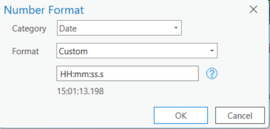

I've also tryed to create a new date field to store just time, settimg the format like this:
As you can see the milliseconds seem to be correctly set....
