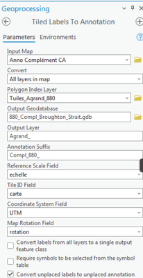

Here my parameters

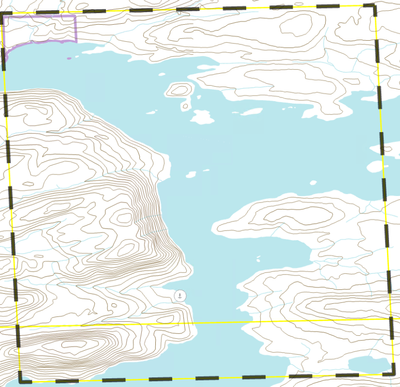

See this is one of my index tile with all my label.

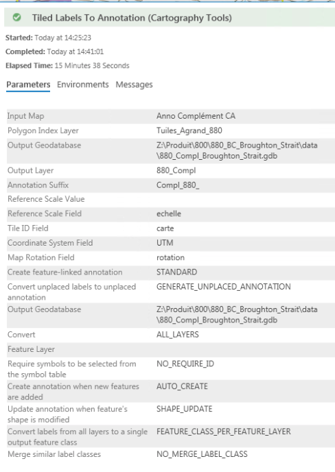

This is my geoprocessing

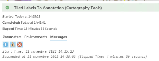

This is the result, my geo database is empty, no annotations from my labeling.  I try whit the database beginning with a number or a character in case it could cause problem.

Pro 3x still generate empty annotation layers.  For ESRI geoprocessing in 3x, everything is fine and successful.
Like said before, work great in arcmap (with TileId field not always populated) and Pro 2x with the same type of data.
What ESRI have broken in geoprocessing to generate empty database.  It's not because it can't do the job.  If I make geoprocessing layer by layer, the database is populated where is should be.
So why, now, when you do a series of layers, annotation layers in the database is empty with a "successful " message.  For me, maybe I'm stupid but, not populated my database is not successful .
