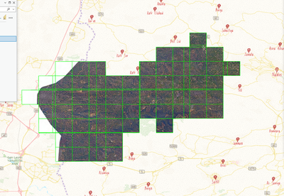

I have a set of panels for satellite images, which are with (tif) extension. I have created a geospatial database that contains Mosaic and contains Raster which includes these panels (like the image below). Please help me convert this aerial image into TPK files that work offline.
Note: The final aerial image inside .tpk files must be at multiple scales.
