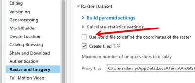

does the *.tif file have a "world file" ( *.tfw)
Raster file formats—ArcGIS Pro | Documentation
if not, go back and see if you can produce one from your input
also check the project settings and see if this is toggled on or off
