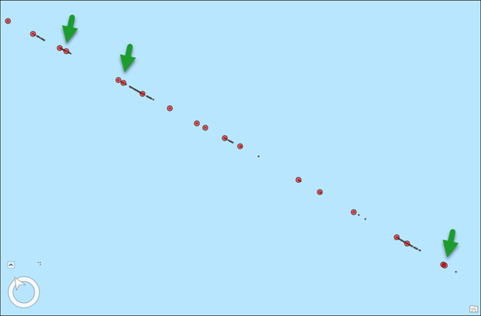

Problem with this SQL is that it produces a result where a few positions are still very close together (see the screenshots below). That is because positions are not recorded at a regular frequency.
To weed out those points too, I have added an additional filter in the SQL - see below.

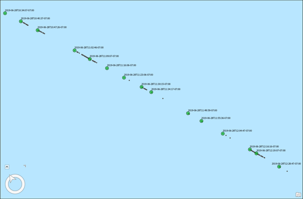

where d.time_diff > 2 or d.time_diff is null
here is the output where green circles represents a cleaner version of the previous one.
Hope some folks might find this helpful in the future 🙂
