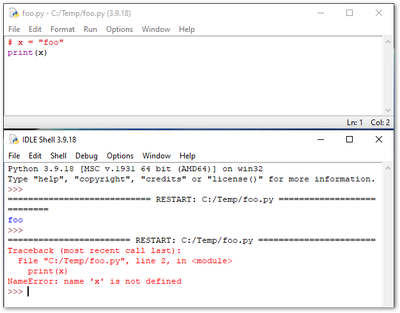

Once you assign a value to a variable in an ArcGIS Pro notebook, it will remember and use that variable for the remainder of that session until you close ArcGIS Pro. It's super easy to demonstrate. It is even better if you do the same thing side by side in IDLE.
In IDLE create, and reference a variable:
Then, edit the code to delete the variable and re-run.
X is not defined.  Good!

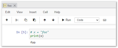

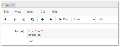

Let's try the same experiment in a Notebook. First, when the variable exists:
Then, when it does not exist
It remembers.  Refactoring code to rename variables in a Notebook is fraught with danger.
