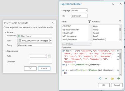

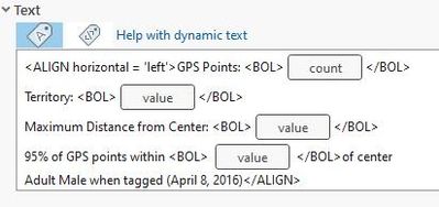

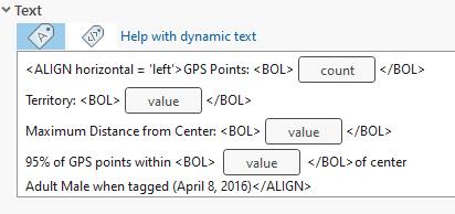

Each of the boxes that says "value" is drawing dynamically from a table or layer in my map
I am re-using the layout and have to change the map in the map frame multiple times (Traditional Map series are not appropriate for this particular use-case-- I have two map frames per page. Also I do not have 3.2 to get Thematic Map Series)
Whenever I do change the map in the map frame, all of this dynamic text falls apart; it defaults to a random layer in the new map and gets rid of my expressions. This is extremely time-consuming to fix.

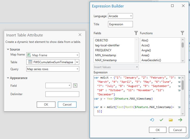

I don't have an answer to the question but a suggestion on how to reuse the dynamic text with other maps.  In the Expression Builder UI, you can export the dynamic text expression to a Label Expression File (*.lxp), then when you change the map for the map view, import the dynamic text expression to rebuild it.  Would that work in this instance?
